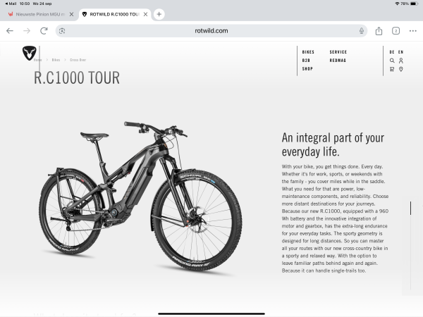

Voor wie zich (ook) afvraagt hoe het roodwild eruitziet…
https://www.rotwild.com/en/r.c1000-tour/19722
An integral part of your everyday life.
With your bike, you get things done. Every day. Whether it's for work, sports, or weekends with the family - you cover miles while in the saddle. What you need for that are power, low-maintenance components, and reliability. Choose more distant destinations for your journeys. Because our new R.C1000, equipped with a 960 Wh battery and the innovative integration of motor and gearbox, has the extra-long endurance for your everyday tasks. The sporty geometry is designed for long distances. So you can master all your routes with our new cross-country bike in a sporty and relaxed way. With the option to leave familiar paths behind again and again. Because it can handle single-trails too.
