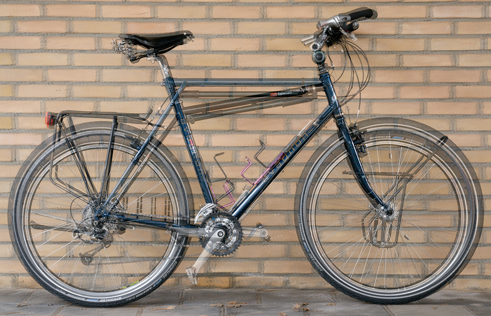

Here's a picture of my 61 cm Avaghon and my 52 cm VSF T-400, positioned over the bottom bracket. They are almost identical in effective size; meaning in this case: top tube length.

If you're looking for a steel bike with conventional geometry, you might want bigger, not smaller, with those measurements.
I'm at 1.84 with an 89cm cycling inseam and my favorite touring bikes are all in the 63-65cm range. I like a French fit.
This is my 65cm Snel Expedition:
